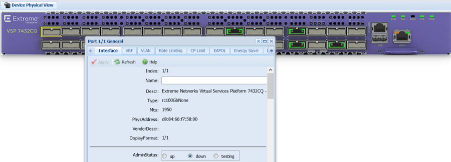

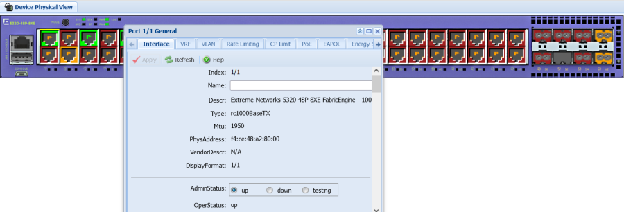

  4. Select and drag the Port 1/1 General tab wherever you want on the screen as shown in the following figure.
  5. To reposition the tab anywhere on the screen, Select and drag the title bar.

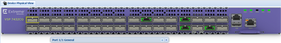

  7. Select the up arrowhead to minimize the tab as shown in the following figure.

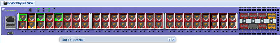

  8. Select the down arrowhead to restore the tab to its original size.
